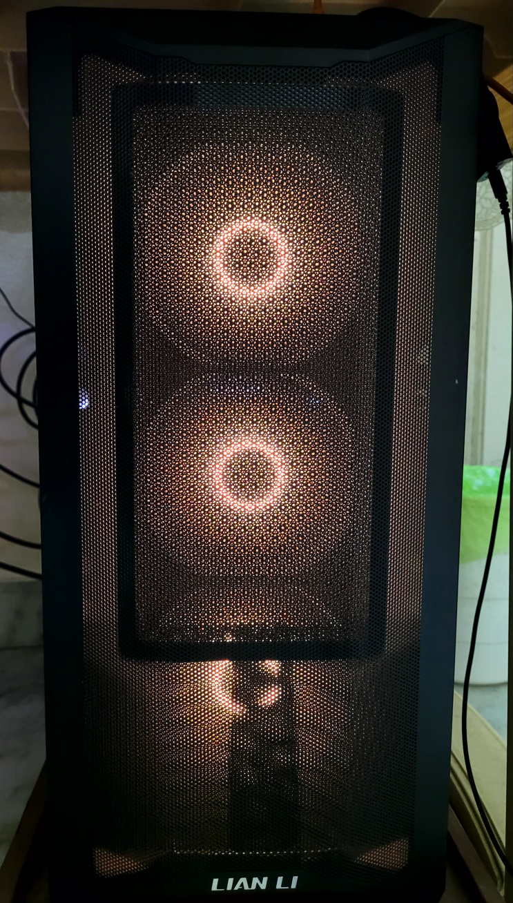

I use a jugaad on my Lancool II Mesh. Inside my front panel, I put a 240x120mm magnetic dust filter & 2 extra 120mm meshes to decrease dust going inside.
can u share link where u got filters from ?
Also are those filters perfect fit for the front if yes then i will do same as you. Buy Lancool 2 Mesh & put after market filters on front.
u cant put the filters under the front mesh panel, on top of the fan directly?
No, can put it behind front fans where screws are. That will be a pain to clean though, also to install. My "jugaad" isn't perfect, but I hope its better than leaving front panel as it is. Also plug the gap at bottom of front panel if someone goes for Lancool II Mesh, Gamers Nexus pointed it out.

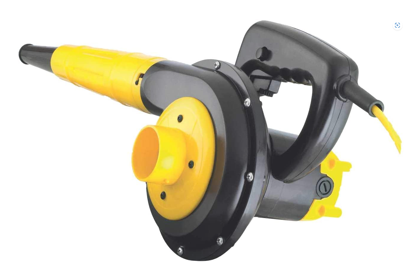

One of my fears. So I got this *www.amazon.in/gp/product/B00OOXFRG6/
But this doesn't help if the dust settled for long time. So need to use soft brush to unsettle the dust and then use spray can.
