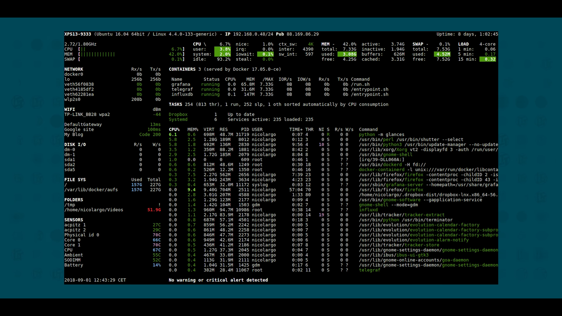

Well, gtop is cool too. But I needed to run it with environment variables:
Code:
LANG=en_US.utf8 TERM=xterm-256color gtop
TFS!
That's only if you use some different character encoding that causes question marks or other garbage characters to appear on your terminal. But then again, you should always try to use UTF-8 as the standard char-set of your system.
Vyom
Vyom
The Power of x480
Well, thanks. I checked and found that my locale was not set to utf-8. So I updated the file: /etc/default/locale and (after a reboot) now gtop works fine!
