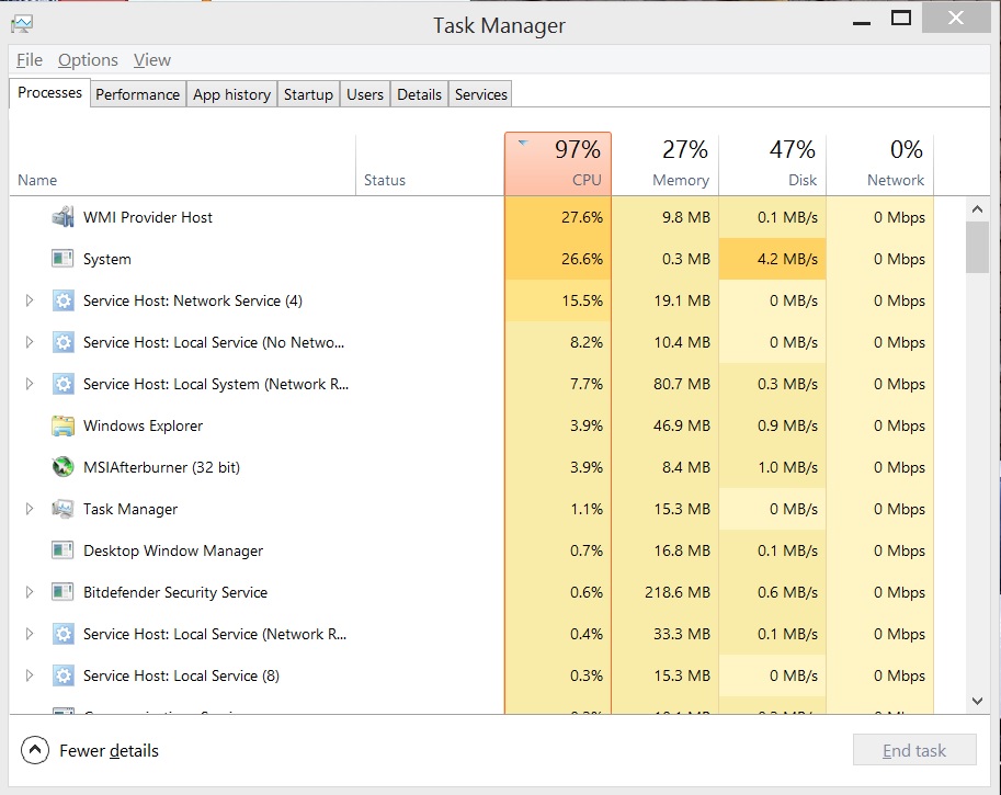

I have a Lenovo Y500 laptop with a 120GB Crucial mSATA SSD in which the OS is installed(cloned the earlier C drive).
Nowadays, when my laptop starts, its CPU usage skyrockets to 90%(even upto 100%) for about 4-5 minutes, then it settles down. This is when power is connected. When its running on batteries, max CPU frequency is 1.17 GHz, so it tskes more time to settle down.
During these 5 minutes everything else runs fine, except for games n other CPU intensive tasks. So how can i solve this problem without reinstalling the whole OS ??
Screenshot:

You can see in the pic which processes takes up more usage, some of them are:
- Service Host Network service (4)
- WMI Provider Host
- System

Do check the screenshot attached
My laptop has 8GB RAM

Can you post a screenshot of task manager with process and startup tab?
There it is

Where are the screen shots? Do post them via any image sharing site...
Nothings seems wrong going by that screenshot. Only those are enabled in the screen shot or there are more after scrolling down?
