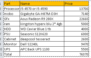

Guys I have decided to go for the following build, much more what i had asked for but i just got greedy, please do tell me if something is unnecessary.. Thanks
  • i5-4570 or i5-4590 13800
  • Gigabyte GA-H87M-D3H 7140
  • Asus Radeon R9 280X 22600
  • kingston hyperx blu 2* 4gb 5000
  • WD Caviar Blue 1 tb 4000
  • Seasonic S12II620 5750
  • deepcool tesseract 2600
  • Dell S2240L 8599
  • APC Back UPS 1100 5500
  • Total 75049

Guys I have decided to go for the following build, much more what i had asked for but i just greedy, please do tell me if something is unnecessary.. Thanks
If you can skip the UPS now and get one later then get this config instead-
FX 8320 (10400)
CM Hyper 101 (1500)
Asus M5A97 R2.0 (7150)
Kingston HyperX 4 GB 1600 MHz (2725)
WD Blue 500 GB (3100)
Sapphire R9 290 Tri-X 4 GB (32800)
Seasonic S12II 620 (5700)
Deepcool Teressect (2700)
Logitech MK200 (750)
Dell S2240L (8500)
total: 75,325
R9 290 will be much much much better than 280X
attachment not available. better upload it in imgur and post the link here.
It's visible. Check again.

so intel i5 4570+280x < amd fx8320 + 290??
intel i5 config wouldnt require the external cooler stock would do so in 2.5 K more i can even get the intel config with 290, is that worth it?
