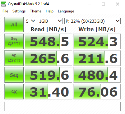

Today I am in the process to install fresh OSes on it. Will post detailed benchmark results later. For now, here is the CrystalDiskMark benchmark (its connected via Sata 6 GB/s port).
*i.imgur.com/xQjwZw9.png

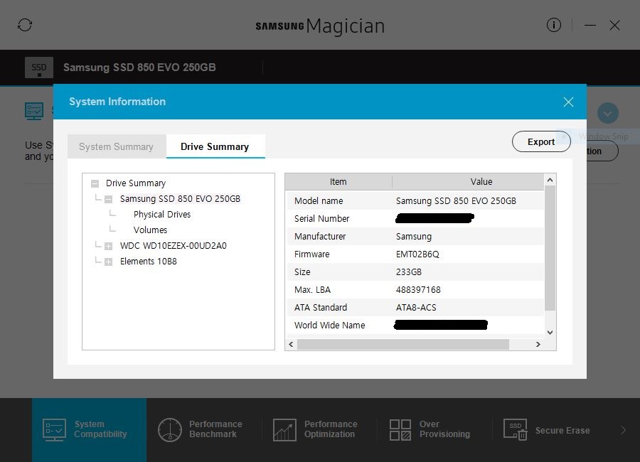

Samsung Magician doesn't say it's connected to SATA 3.0 port. It only says in terms of speed. On my Samsung Magician it says the interface it's connected to is SATA 6.0 Gb/s.
What exactly your magician says?
Check if in the Drive Summary, the magician reports ATA standard as "ATA8-ACS".

samsung magician says "your drive is connected to sata 6.0gb/s (SATA3) port and should show maximum performance. ata standard is ata8-acs

After seeing yours, I was curious to know what I am getting with mine. It's lot slower than yours, I guess it's because of old chipset.
Left one is HDD and right is SSD
Drive info snapshot from Samsung magician.
