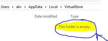

Step 2 : Copy the incomplete file ( yournokiafile.exe ) to this folder : C:/users/<your user name>/AppData/Local/VirtualStore/Program files (x86)/GnuWin32/bin/<yournokiafile.exe>
i cant find a folder c:/users/............/virtualstore is empty(i have already enabled 'show hidden folders'). should i create the folders 'Program files (x86)/GnuWin32/bin/'??
NO
OH ! I forgot to ask you, is your windows 7 32bit ? If yes then put the incomplete file in this location: C:/users/<your user name>/AppData/Local/VirtualStore/Program files/GnuWin32/bin/<yournokiafile.exe>
