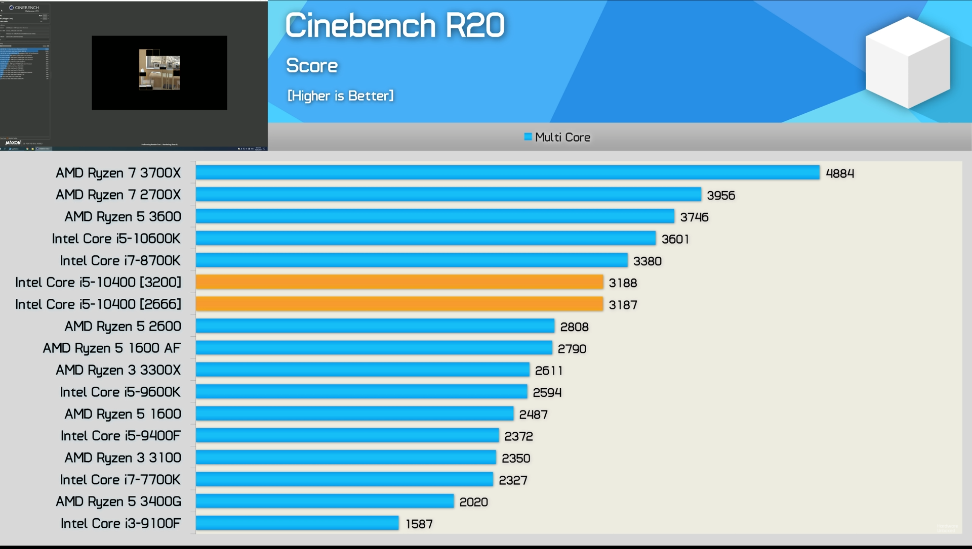

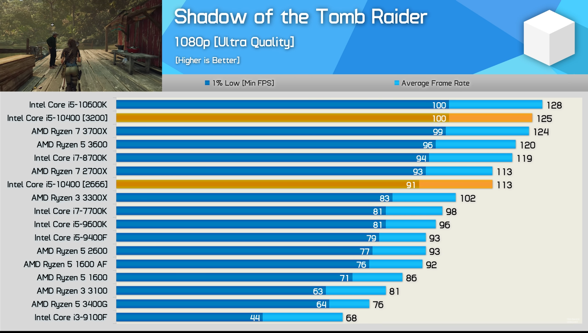

I know people running R7 5800X on B450, so B550 is surely not required. Also, Ryzen 5000 is the last-gen with AM4 socket. Next-gen will have a new socket. Get R5 3600 (17k) + Gigabyte B550M DS3H (9k) for AMD for 26k instead of R3 3300X + B550 Gaming Plus (12.3k + 13.7k). As said earlier, don't both with OC much.
A GPU will help you buy a CPU w/o iGPU like R5 3600 or i5 10400F.
Again I'll say that i5 is a better performer if you want to save money, its a 6c/12t CPU & 10400F just costs 12.5k with some sellers:
Intel Core i5-10400F 10th Generation Processor (12M Cache, up to 4.30 GHz)
Garv1386
Garv1386
View attachment 19985View attachment 19986
