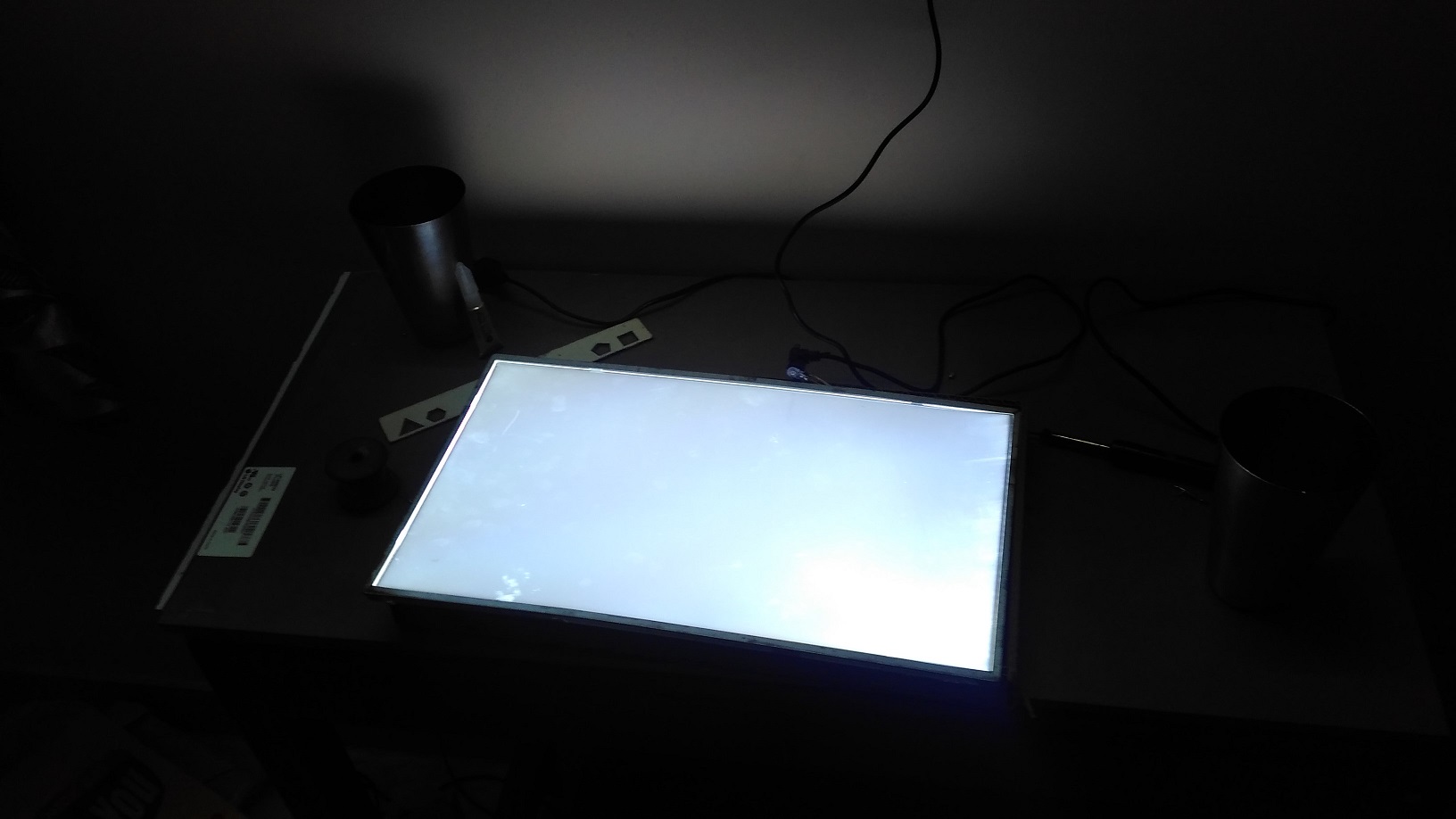

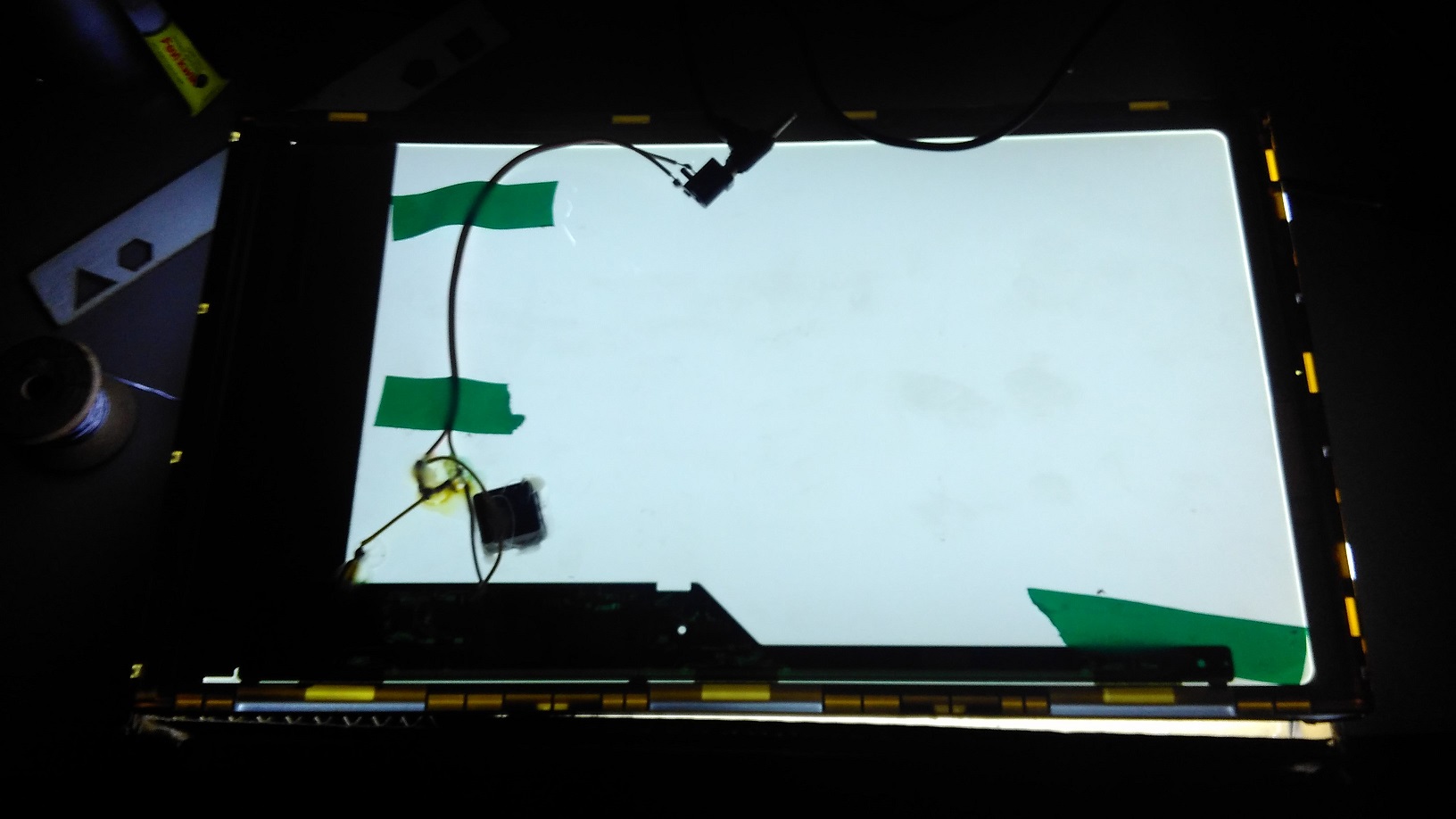

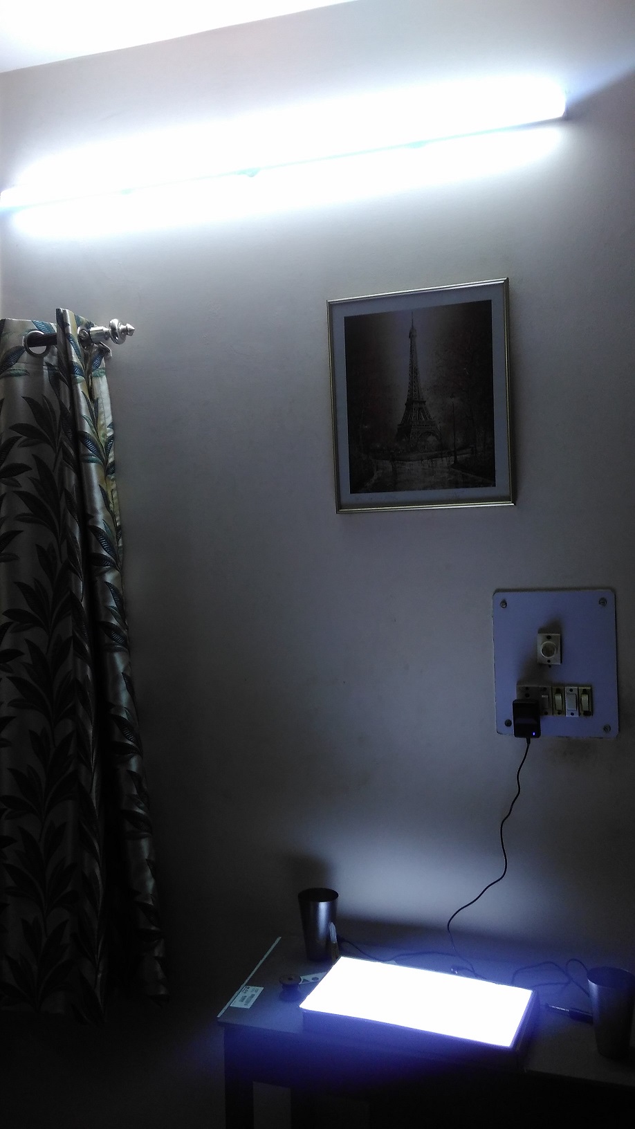

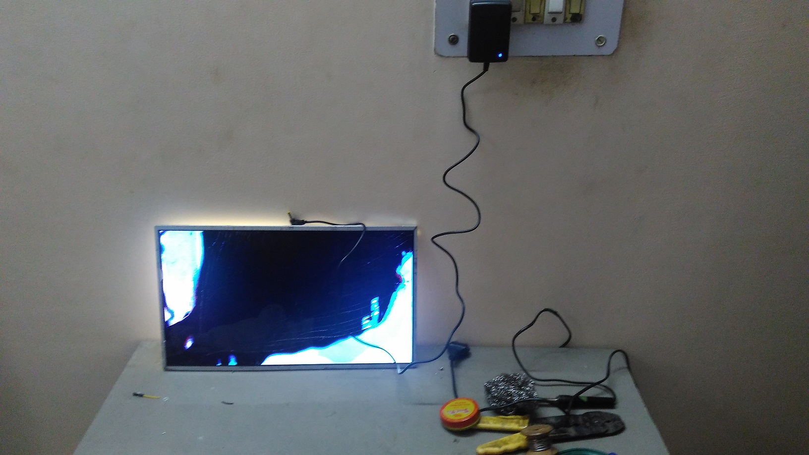

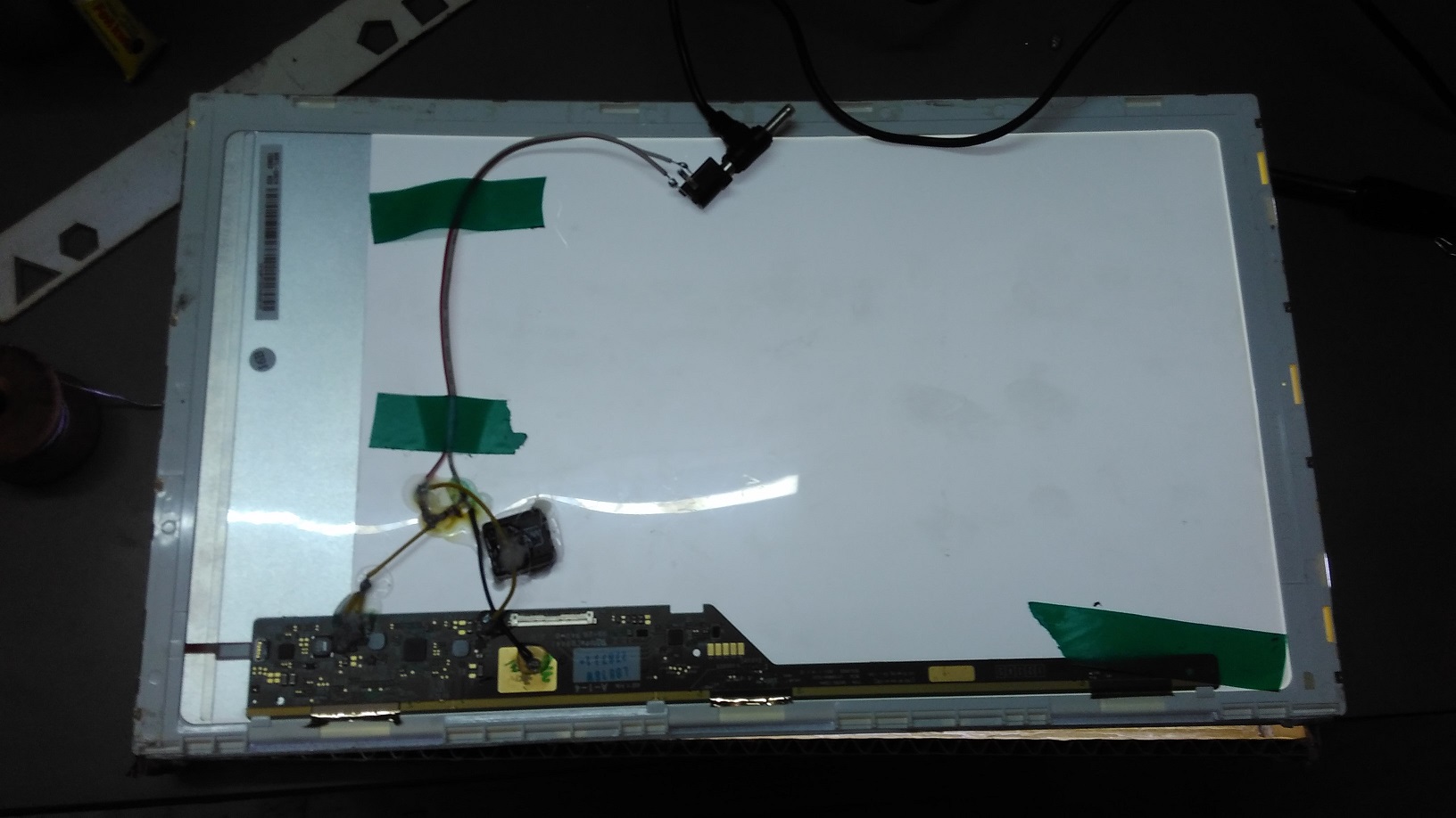

@Vyom This just uses the LED back lights in the display, the LCD part is removed. See pics..
The light is strong for 4.3W, but not soft. In fact can't have it in a position like a window, light is not spread out enough to have it eye level, unless the room already is well lit. I was hoping the light to be softer.. but that should be fixable with some diffusing sheet. That's the plan now.. create 2 more such pieces and cover them whole with a sheet.
The soldering is holding. Made a simple temp cardboard frame to keep the LCD on.
Pictures: Apologies for the quality. Can post better pictures if someone wants to see..
Back soldering:
with the LCD panel
front light, LCD panel removed
light on, back view.
comparison with tubelight
