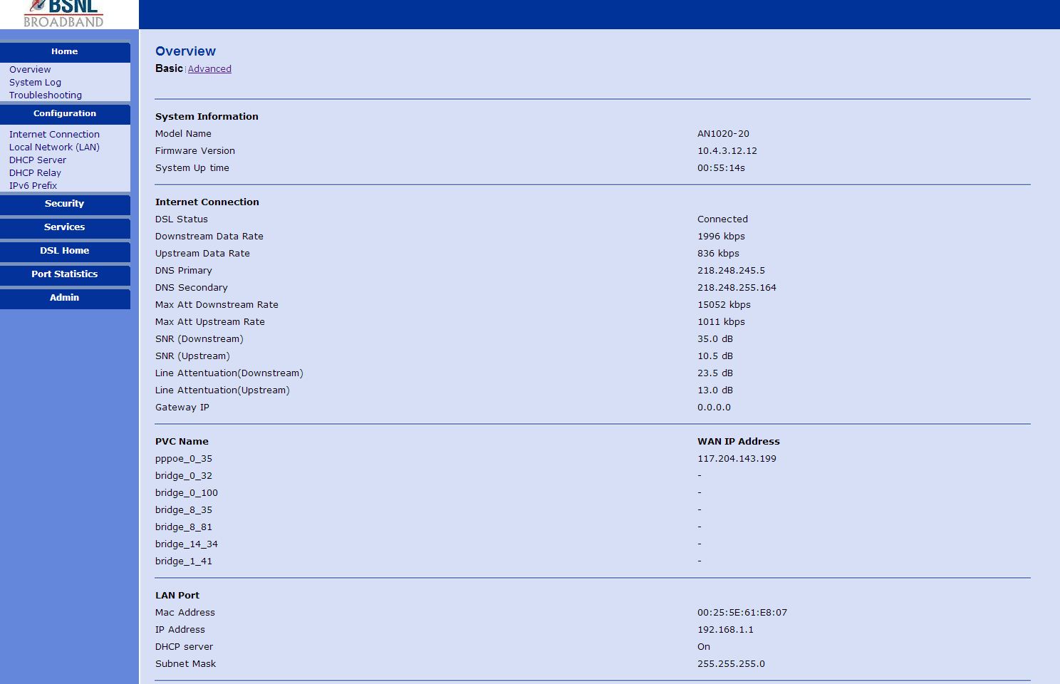

these are the bsnl modem settings screens..
you have to change your pc lan settings by manually assigning ip address(network sharing center--adapter settings--local area network left click select properties & then select properties of ipv4)192.168.2.100(just an example),subnet 255.255.255.0 & gateway as 192.168.2.1.after doing this you should be able to access both 192.168.1.1(modem) & 192.168.2.1(router) from your pc.
btw in your 1st pic snr(upstream) value is very low.it must be above 15 for a stable connection so try disconnecting & reconnecting all phone line connections(modem & splitter) to see if it helps.

are all my modem settings ok? if u see the screenshots
it is already LLC bridge mode..
bridge mode?your modem is setup in pppoe mode & is working correctly.did you tried my suggestion of changing your pc lan ip setting?do it & you should be able to access router from pc.

i mentioned bridge becoz it shows in this screenshot , and the link u had sent also asked to make it bridge mode...
so my guess is that im missing some setting in my bsnl modem...
my wifi router is set to pppoe, i have put in my bsnl login and password, and wep security.
in that screenshot you need to focus on starting word/letters which is PPPoE not LlcBridged which is a subset & will be there for both PPPoE & Bridged.as for not accessing router from PC that's not the point.the point is to setup a network in a simple & easy to remember/configure way so that in future chances of problems will be less.it is logical that if you are connecting pc to router then its ip address should correspond to router(in this case 192.168.2.x) & you are right that link i sent mention modem in bridge mode but i skipped that part because i wanted you to first setup your network to at least get net access over wifi so that you learn enough to make changes in future.setting modem in bridge mode is preferable because then you only have to configure your router for things like port forwarding,VoIP,online gaming etc.
let's start from beginning.you first have to change your modem from pppoe to bridge.before doing that note down your bsnl username/password because in pppoe mode it is saved in modem itself & will be deleted after changing to bridge mode.to convert to bridge mode click on delete icon in front of pppoe_0_35.after you deleted it click on add & a wizard for setting up new connection will appear.name the connection as bridge_0_35 & just select the default values & enter vpi as 0 & vci as 35 & keep clicking next.on the screen where it asks type/protocol select rfc1483bridged.after completion you should see a connection named "bridge_0_35" with 0/35 in front.
