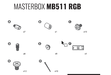

Is this an issue with how the fan is fitted? The only thing I noticied that is different from the two top fans is the way different screws are used The bottom one has 4 long screws. What are those long screws called? The screw named H below

Ask your seller for help, send him the video. I don't think screws will screw fans, likely some connection issue. Check online on how to connect fans, try removing & reinserting wires on pins on the mobo.
