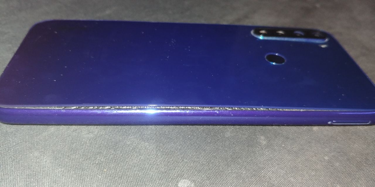

Well I observed that battery is swollen. Seems like cost cutting to me by Chinese manufacturers. :(
My LG g6 is 4 years by comparison, and only battery backup is short, compared to 2.5 yr of Redmi and phone shutting down even if I start a YT video, no matter how much battery it indicates.
I would not put this phone on charge anymore. It would be safer to give it away to e-waste management.

Correct. I have turned it off since I observed it. And not charging it anymore.
But seems like there are solutions available on YT to fix it by using a needle to carefully puncture the battery so that the air is released. However I dont think I should try to do that and just get the battery replaced.
Do not attempt to puncture the battery! I have seen enough of bulging battery videos to know this should not be done in any case. The content of the battery may catch fire after coming in contact with air. The fumes from burning Lithium batteries are toxic!!

Not cost cutting, low QC maybe. My Alienware laptop's battery got swollen, so can happen anywhere. Just bad luck. Get a new battery or new phone.
Get original one from Xiaomi.
Battery swelling is a common problem. My Apple Ipod Touch (2011) had this issue in 2016.
>> Do Not attempt to mod the swollen battery <<
Try for a official replacement or buy a new one, whichever is cheaper.

Alright got the battery replaced.
Service Center was asking for Rs 1600 to change battery of Redmi Note 8, which is Rs 999 from official sources. Which is ok, 600 might be there service charge. But then they will do repairing in a closed room, away from my prying eyes. Hmm.
I thought ok. Let's give them.
But then they also asked pin of phone, reason being they will QC the phone. I said just battery needs to be replaced. So they just need to make sure display is ok.
In the end, didn't trust them enough to give phone to service center. Got it replaced at half cost at a known local place.
