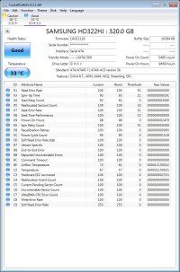

OP, can you post the report from CrystalDiskInfo here for both of your hard drives?

Attached are the screenshots from Crystaldiskinfo. There's a problem with WD HDD. Can it be fixed?

The one which is in caution can fail anytime. So your call. I won't keep anything important there.

I'd personally move all important data to a healthier drive and keep only non-essential data (ones I can afford to lose, music, movies, etc.) to the unhealthy drive.
