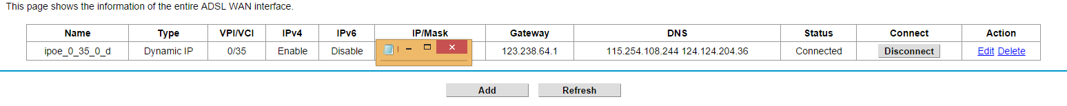

I too am using reliance broadband, i am currently using TP-Link TD-W8968 which works perfectly with the connection, Before that i was using Asus RT-N14U which also worked great. I think most of the modems will work fine, but i may be wrong.
Any tips on getting it working with reliance ?
You need to set your connection type to DHCP / Dynamic IP.
Also you need to set the VPI to 0 and VCI to 35 in ATM Config.

Thank you Scorrel. So if you connecting multiple PC by WiFi or LAN, you need to login to reliance from any one PC and every other connected device get internet ?
I was planing to get a TP-Link modem, so i will get the one you suggested, looks good. If you don't mind, can you please post screenshot of the configuration page ?

If you want the backup file of my config let me know.

Pmed you the Config file.
