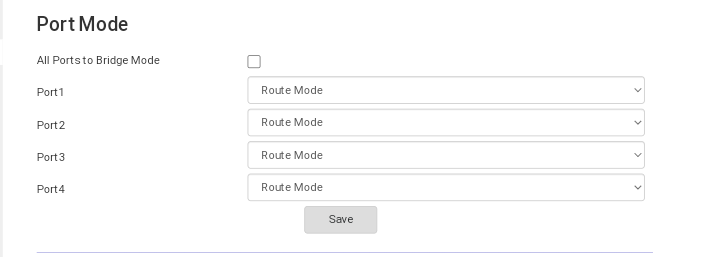

Just connect the two lan cables,
Make sure that Airtel Xstream is in Route mode for all LAN ports( that is factory default settings btw)

1) On Xstream fiber

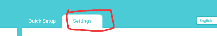

Then open the setting tab as shown below

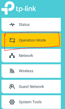

Now open Operation Mode from side menu

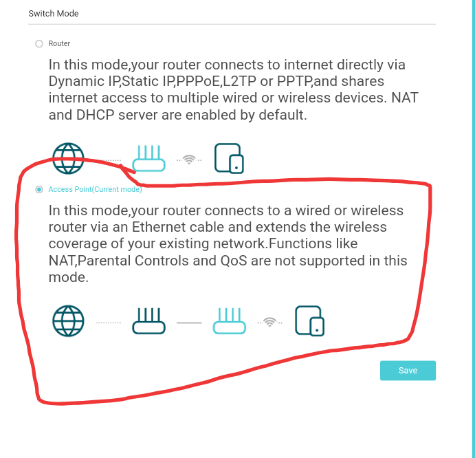

Now click On AP Mode.
And that's it. There is no need of doing any pppoe Mac auth. Or even call the rudest cc of Airtel.
This setup does not require any backend changes.

1) On Xstream fiber
