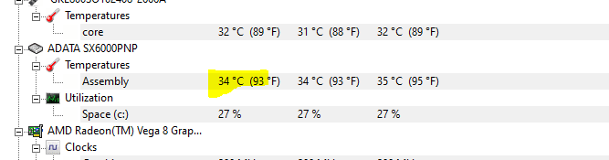

Why does the SSD show that much temp? The laptop is hot to touch on the left underside. Is that where the SSD is?
Adata SX6000 NVMe ssd was/is infamous for its high temps. I am surprised acer used this particular NVMe model for their laptops. However it should not be this high under idle conditions, were you doing some intense read/write operation(or maybe some scan taking place) when you took this measurement.

Steam client was downloading a game. I did try gaming for some 30 minutes before that.
Temps are down when I turn the laptop on after a while.
Then that's normal, this SX6000 series runs hot so any intensive read write task will easily push it to 70C+ but try not to use it in such way often.e.g.wait for ~1 min before using steam client after just finishing a game etc.

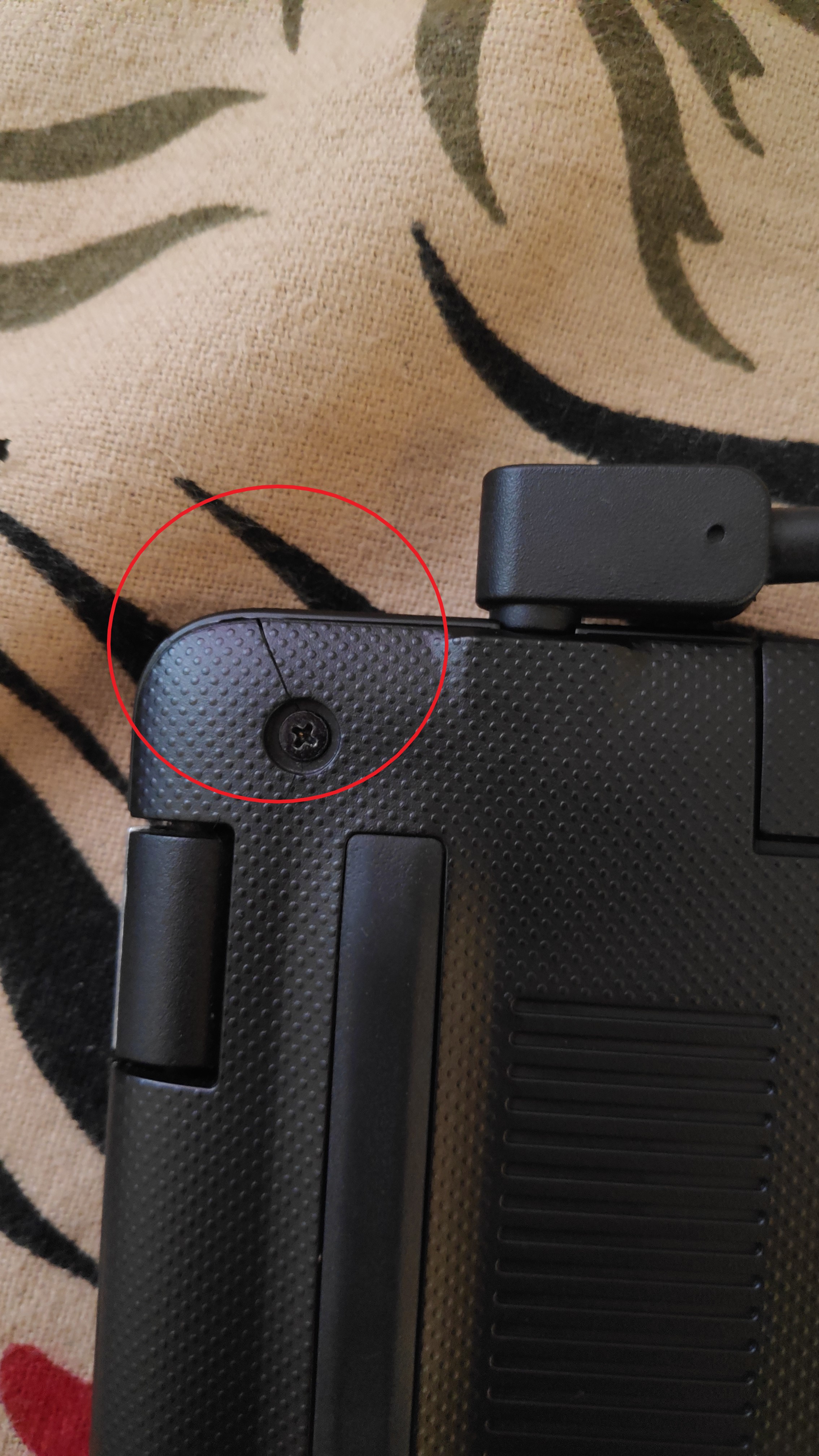

I see this crack in the laptop case after my visit to the Acer service center. I am pretty certain this happened during their service. But the chat support team says this won't come under warranty. How should I resolve this?
I have sent mail to their support team, is there any other contact where I can escalate this?
Pretty sure service center guys tightened the screw a bit harder and this lead to the crack.

You could also register an online complaint with the consumer forum if they refuse.

Yes, they escalated my mail to next level and then refused, saying the damage did not occur at their service center. Let me check how to complaint with consumer forum.
Ask them if the laptop was taken out from service center during the RMA period then.
Please do post the location of this service center and name so that we can warn other forum members in case anyone have to deal with these guys.
