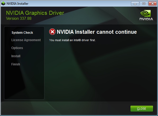

I recently bought an HP 15-022TX notebook (with NVIDIA GeForce 820M card) from Flipkart. I installed Windows 7 Pro 64-bit from DreamSpark and downloaded the driver for the card from here.
Now when I run the setup, it gives the following error -

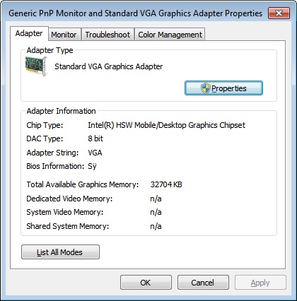

Now I wanted to determine my Intel Graphics driver so here's the output of 'Right click on desktop' -> 'Screen resolution' -> Advanced settings' -
So how do I determine which driver to download from the Intel Download Center? In 'Find by Category', I looked in 'Graphics' -> 'Laptop graphics drivers' but none of the drivers listed seem to help.

Check the tech specs for your laptop and install the Intel HD Graphics driver first. Then proceed to installing the Nvidia driver.

[MENTION=171475]ankush28[/MENTION] Thanks for the link. I downloaded and installed SlimDrivers Free from CNET and it automatically detected the old driver and downloaded the latest intel driver.
