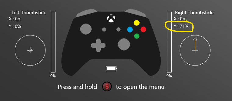

Since last week my XBOX one controller right thumbstick is drifting up (Y axis) on its own by 71% (Check screenshot below)
Can I repair it or Should I buy a new controller ? Warranty is over.
