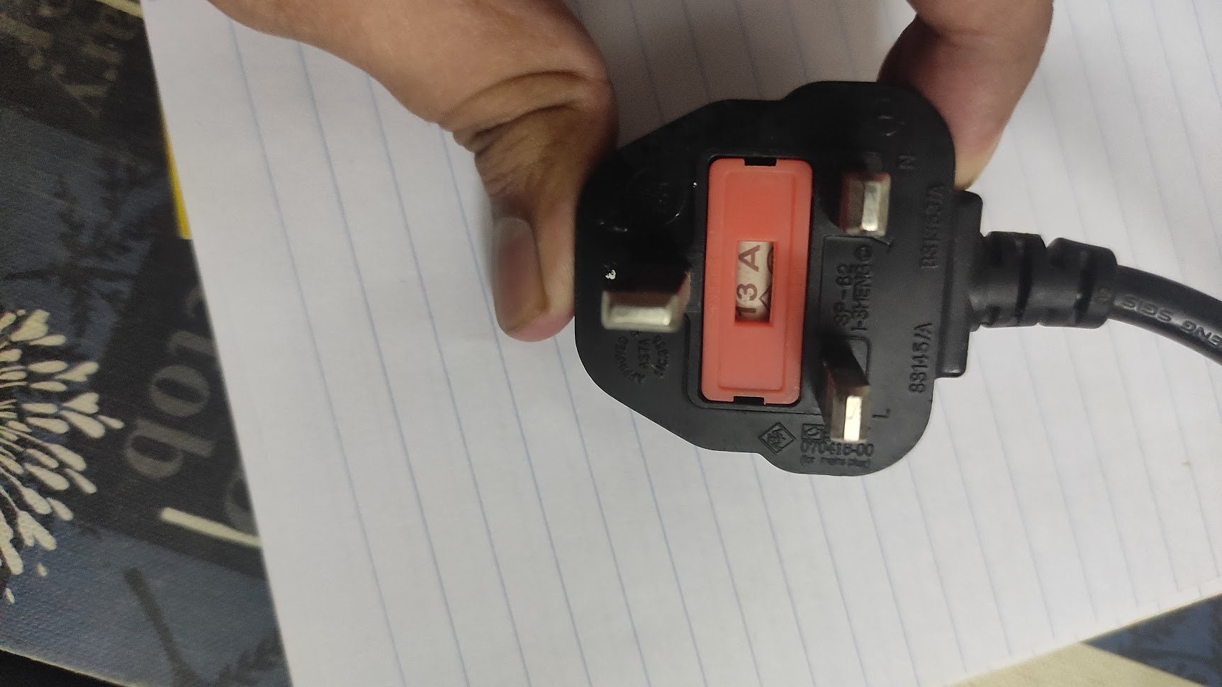

I see that it has normal round pins but my psu has block pins IMG_20201227_210251.jpg

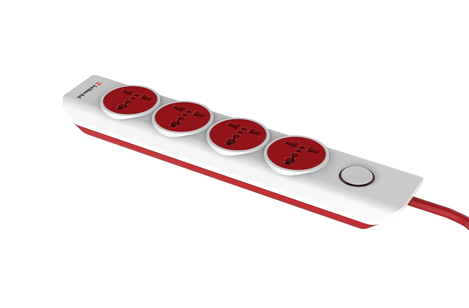

So can I connect ups -> gold medal extension box 71P0ZAIcF9L._SL1500_.jpg -> psu or

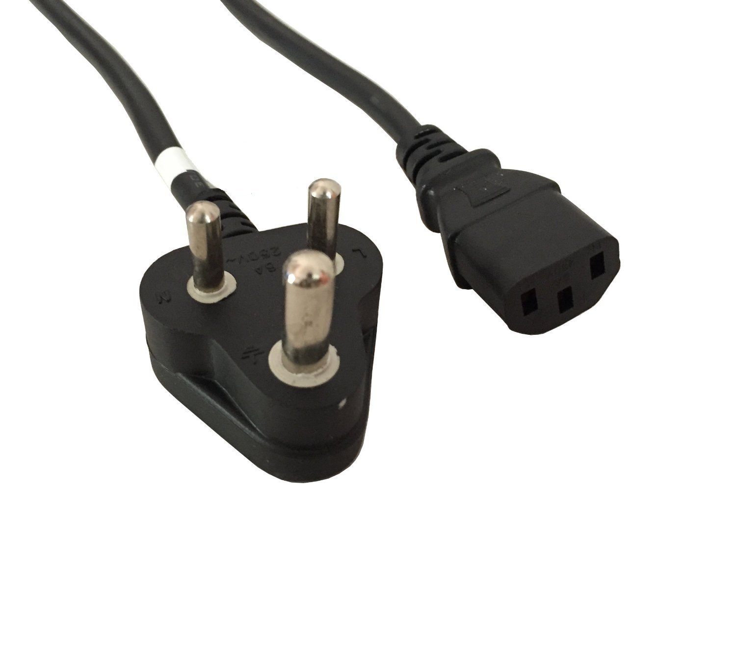

I see that it has normal round pins but my psu has block pins View attachment 19869
So can I connect ups -> gold medal extension box View attachment 19870 -> psu or
do I need to buy a Indian plug View attachment 19871

Block pins is fine as long as the ground is making contact, I have a non protruding ground pin, the protruding portion is meant for the sockets in EU countries, hence i had to change. You dont necessarily need to change as long as the UPS has the appropriate socket that can accomodate block pins.

Yeah that's the right model indeed. You can even get the 800va version , the only downer being it has no option for pc connectivity which the 700va model has.
To connect your uk style plug you will have to use a universal power strip like the one you have shown in your post, and then connect the power strip to your ups-that's what i do as well.

You can get a flat pin to round pin adapter plug for ~50 in local electric shops or nowadays most powerstrips/extension boxes come with universal pin compatible sockets anyway. The max power consumption of 1660 super is around 130W so a 600VA ups(which provides 360W) should be fine but as suggested above you can get the better 700VA model if you have the budget.
