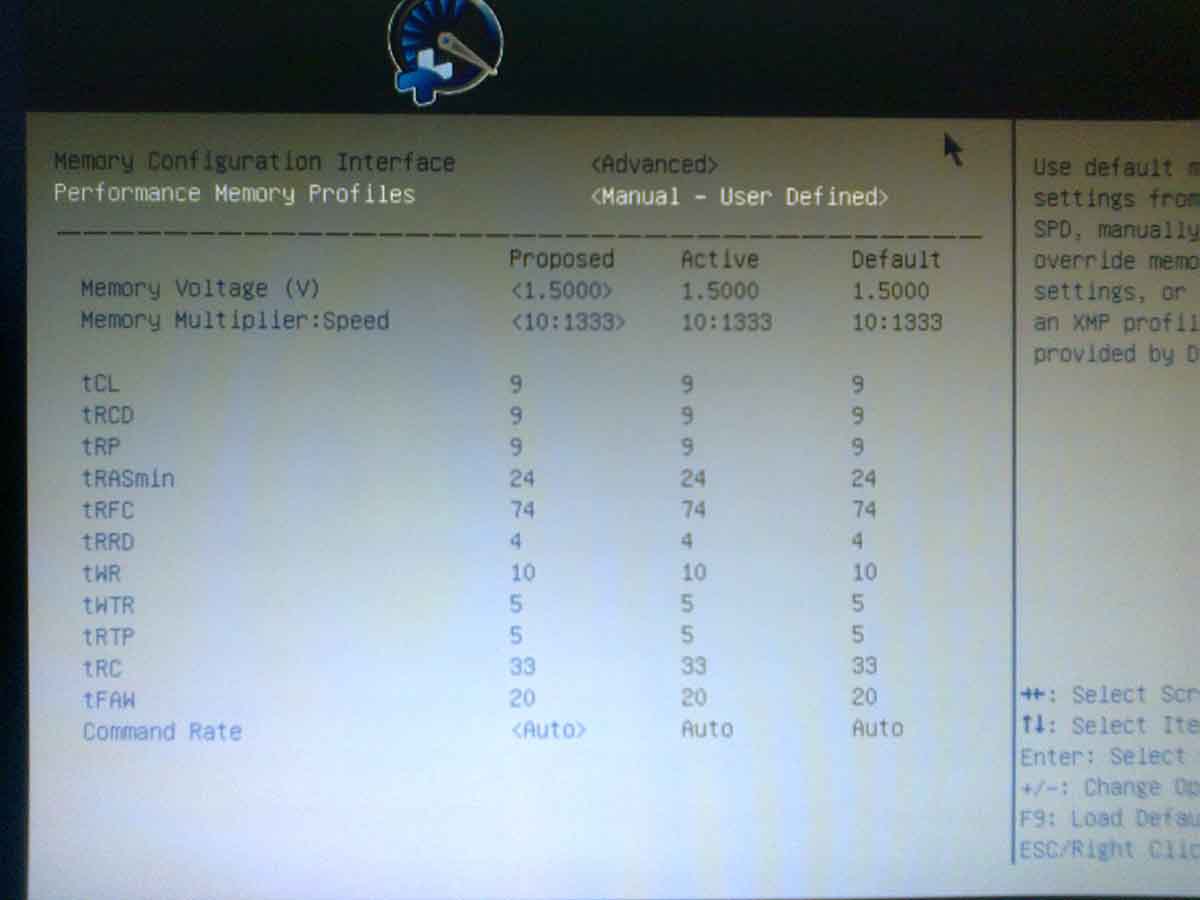

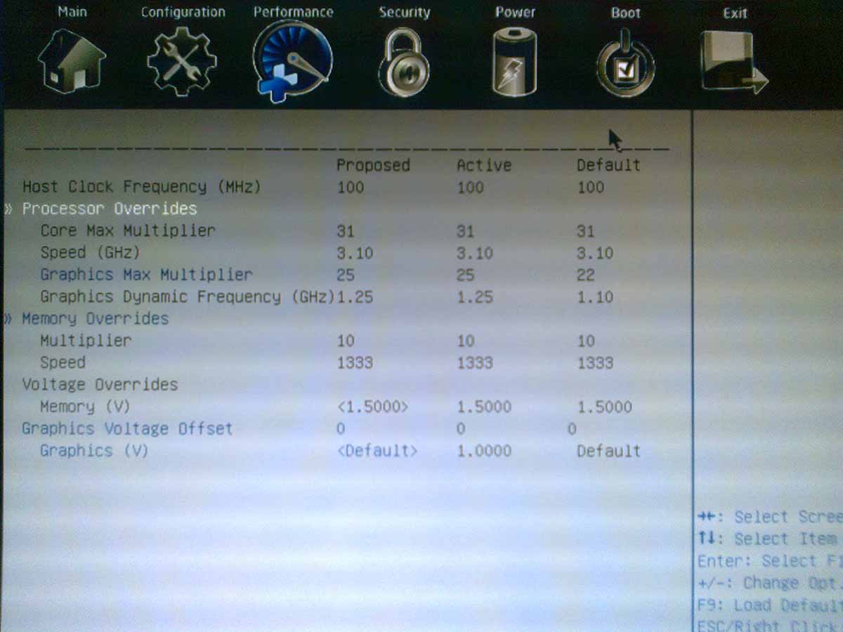

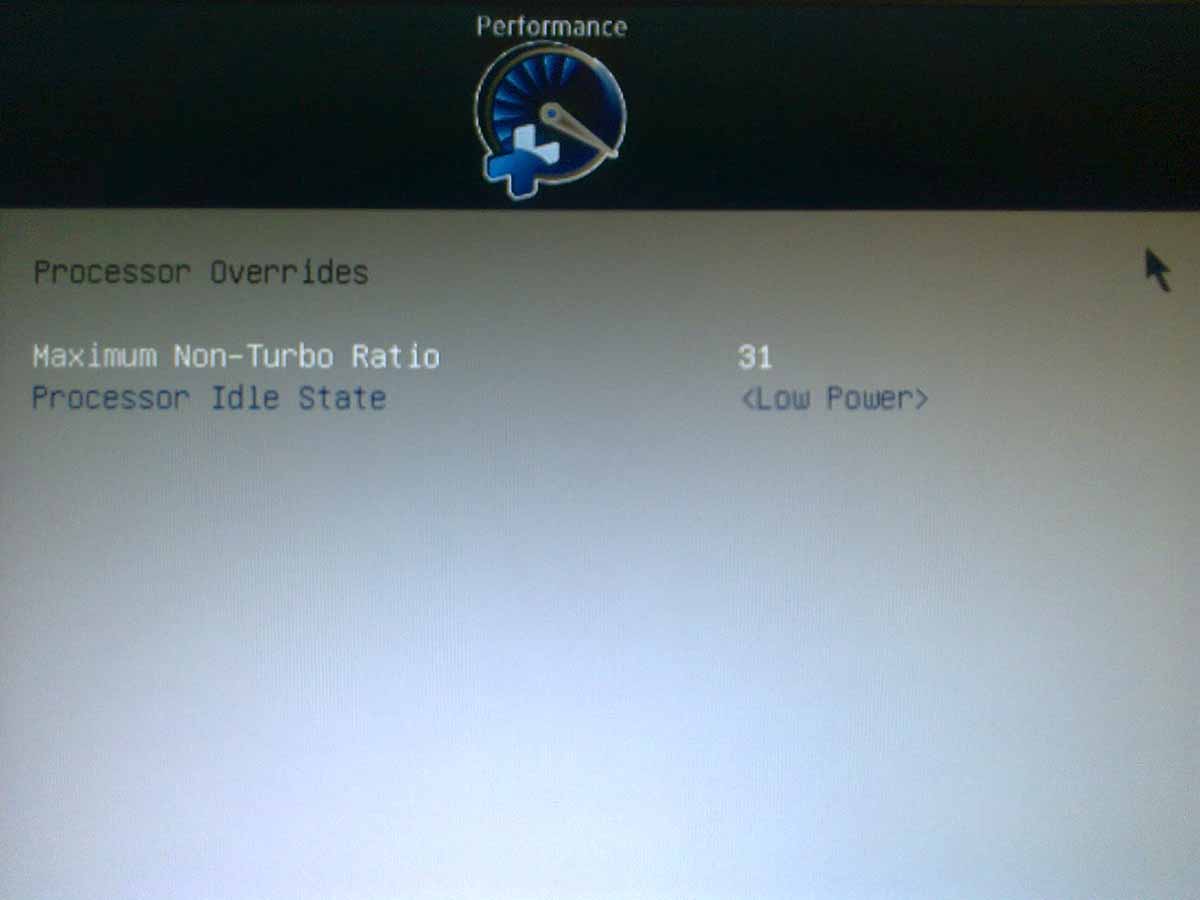

Check these images, from BIOS update 0048 and above (mine is 0109) bios has got all of these options for overclocking.
