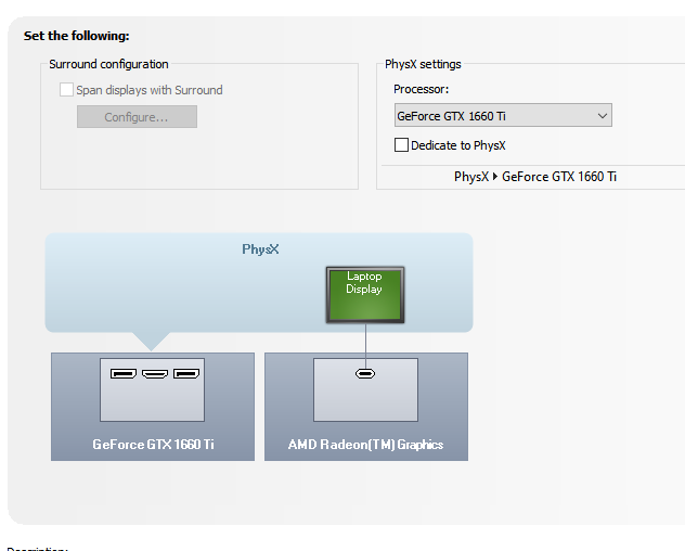

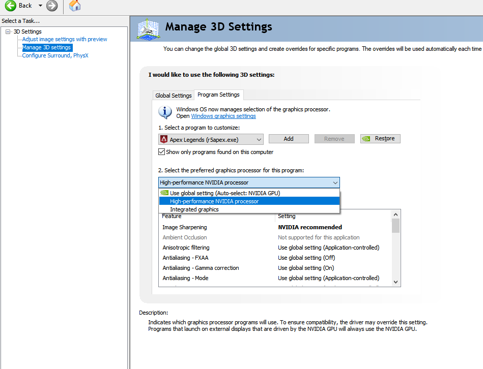

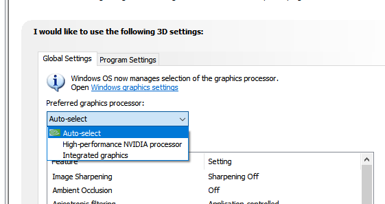

Does he have an outdated BIOS on his laptop? If so, ask him to update to the latest BIOS and set it to default settings. Also tell him to open BIOS and check if there are any settings that conflict with video card or RAM installed. Reinstall the latest NVIDIA driver and other drivers for the Radeon GPU if required. Set the driver settings to default and run the game. Check if NVIDIA card is being used after launch.
