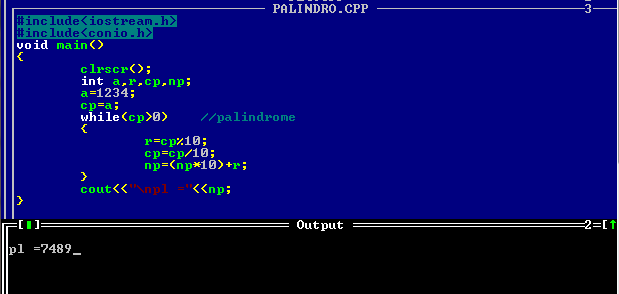

Here's the code for checking the palindrome block separately, there was no need to setting np back to 0 here, but still wrong output:
rijinpk1
Can this code be logically correct?
