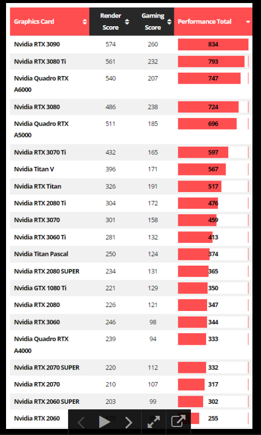

just saw this it seems a 3060ti has better performance than A2000 in enscape.. Revt si more CPU bound. So 3060Ti would be a better buy right ?
*forum.enscape3d.com/index.php?thre...s-for-enscape-are-serious-hard-to-understand/
DestGod
Well, true, the RTX 3060 Ti would be a better buy. But keep in mind, it also costs about 7k more than the RTX 3060.
IMO, the RTX 3060 is already good enough for productivity. It comes with 12GB VRAM (with handicapped bandwidth but 12GB nonetheless).
