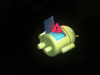

As there was no separate reset button/key, I tried with combination of power key and volume up key(holding it for more than 10 sec and untill I got this image) 7885263992_1b0cd197d3_n.jpg after this i don't know what to do.

As there was no separate reset button/key, I tried with combination of power key and volume up key(holding it for more than 10 sec and untill I got this image) View attachment 7665 after this i don't know what to do.

thetechfreak and kg11sgbg thanks for the suggestion.. but no luck...
i did exactly same way..
Press the Volume UP(vol.+) key for 5secs. and the Power/on-off button simultaneously.
Release the Vol.+ key and the Power/on-off button,but IMMEDIATELY(within 10 secs. time of release of vol.+ button) again press the Power/on-ff button and hold for about 6 secs.
when i press power button +volume up key I get the android error logo (the same pic) but the device shutdown itself when the power button is pressed for more than 6 sec.
I tried several combination while its in error logo like ( only volume up for 6-10 secs, only volume down for 6-10 sec, both vol up+down for 6-10 sec) but nothing happens.. along with this combination if i press power key for more than 6 sec then it goes power off!.
its just the error logo no other option menu is visible...
any other option i can try..?

^@thetechfreak, the image you posted is normal recovery procedure. but i am getting the same logo with a "red triangle and exclamatory mark".
check this pic
does this mean the recovery function itself corrupted..!!

^^Yes, you are correct .Picture posted by @thetechfreak means normal recovery procedure.
